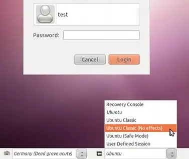

The easiest way is to use the session that's there to do exactly what you want. ;-)
  • Log out.
  • At the GDM login screen choose the Ubuntu Classic (No effects) session:
  • Log in.
    → You will be in a classic GNOME session without Compiz. Subsequent logins will use this session as default.
