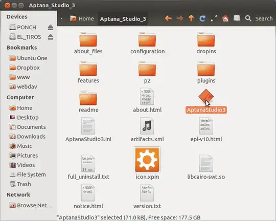

If you downloaded standalone version you can place Aptana Studio in whatever Folder you wish and invoke it by double clicking in the AptanaStudio3 icon as shown in the next screenshot:
