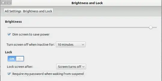

This is my settings in System Settings -> Brightness and Lock

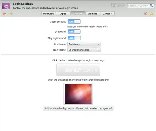

And in Ubuntu Tweak the Login Settings:

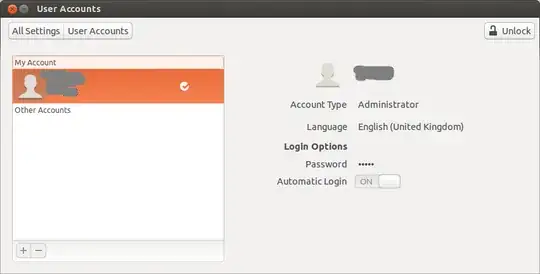

It could be worth checking your user account and making sure that the Automatic Log in option is set to Off
As you can see from the image above, I have mine set to ON.
