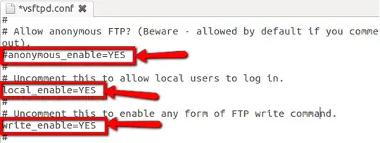

To install an FTP server, try out vsftpd. To install, just press Ctrl+Alt+T on your keyboard to open Terminal. When it opens, run the command(s) below:
sudo apt-get install vsftpd
Once installed, you need to edit the config file
sudo gedit /etc/vsftpd.conf
Make sure that you change the items shown in the image below.
Once done, do
sudo service vsftpd restart
