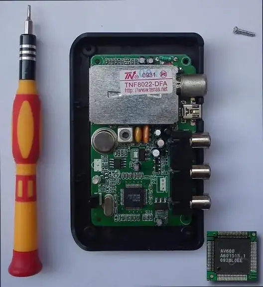

Update 4 I tried adding em28xx as the chipset (as suggested by user BOBBO below) for the tuner but that did not work. I went back to my Pinnacle PCTV internal card. I don't think the tuner referred by UbuntuForums (Gadmei UTV 330) and the tuner that I have (Gadmei UTV 302) are the same. My USB tuner is several times bigger. My tuner seems to be a newer device with a newer tuner chip. I will submit details of this device to the LinuxTV developers this weekend.
Update 5 I opened the tuner box and found that it uses a tuner from a Chinese company - Tenas. Model is TNF 8022-DFA.
Circuit board of Gadmei UTV302 TV tuner showing Tenas TNF 8022-DFA tuner chip
Update 6 Tuner chip specs (retrived from supplier directory) for Tenas TNF 8022-DFA.

Update 7
  1. Reverse side of the circuit board.
  2. Picture of the TV tuner
