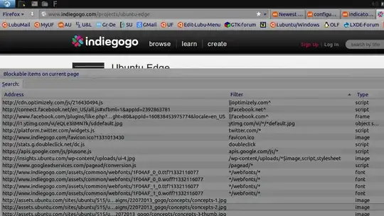

To address this specific aspect: but loading and refreshing the fundraiser site is distracting and not really handy.
A general way to lighten websites is by blocking the loading of "elements" you are not interested in thereby speeding up loading of the site. By blocking certain urls on various sites, I'm able to access sites that would normally take ages to load on a slow network.
Blocking loading can be done by means of the hosts file or by using an ad-blocking extension in your browser. I use AdBlock Plus which is available as a browser extension. The image shows the list of blockable URLs:
blockable urls
As an aesthetic measure which may not improve the loading time of the page, you could further block the display of elements you aren't interested in seeing by means of css. The Stylish extension available for Firefox and Chrome, allows you to create site-specific css rules to allow hiding of elements.
