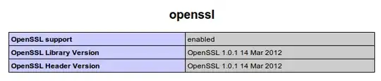

I think SSL support doesn't depend on an extension, it's already built into Ubuntu's PHP. Try creating a PHP file in your web server with this content:
<?php phpinfo() ?>
then access it in a browser (http://<server>/<file>.php). You should see:
and
I have only these PHP packages installed: libapache2-mod-php5, php5-cli, php5-common, php5-gd, php5-mcrypt, php5-mysql.
