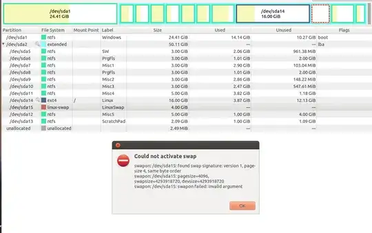

I created the SWAP partition in GParted after resizing my Ubuntu partition. All the operations went off smoothly. When I right-clicked the SWAP drive, it showed "SWAPON", so I clicked it & it activated the SWAP. Then I restarted the machine & it showed the SWAP as SWAPON again, so I hit it & it failed to activate it giving this error message:

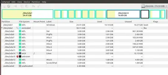

Then I shut down the machine & restarted. The HDD looks like this now:

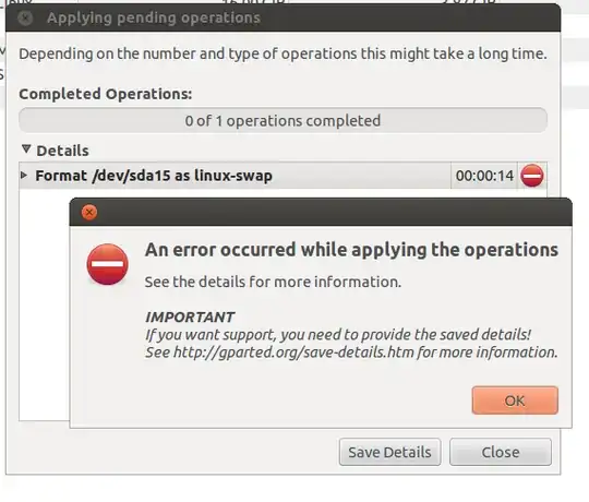

Then I tried to format sda15 to linux-swap & it could not do it giving the error message:

As your snapshots are showing you have so many partitions on your system. So first check if you're not exceedingly the limit of number of primary partitions which is 3 or 4 I don't remember exactly. If you're not exceeding that limit than try to make swap area first and than go for ext4 partition.
