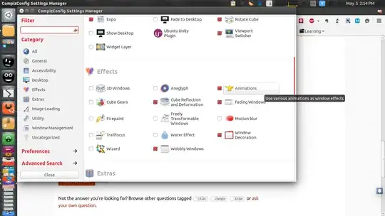

Try this please: Compiz Experimental
It always work for me, i am on Ubuntu 14.04. enter image description here
