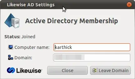

  • Likewise-open Gui is already installed, but I am not able to leave the domain and re-join.
  • See the following screen shot:
LIKEWISE-OPEN-GUI

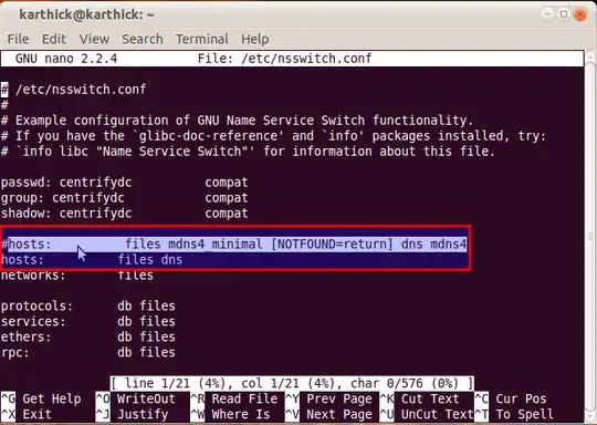

Configure nsswitch file:
  • Open the terminal and type the following,
    sudo editor /etc/nsswitch
  • Search for the line that says
    hosts: files mdns4_minimal [NOTFOUND=return] dns mdns4
  • Put # infront of that line and add a new line
    hosts: files dns
  • So that the file will look like nsswitch file
