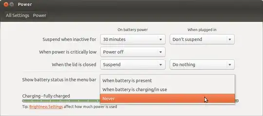

Try to checked if you may have it set to show the indicator to "Never".
Just go to "System Settings..." -> "power"
See in this picture
