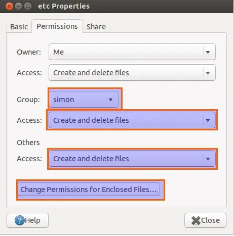

The easy way is to:
  1. launch nautilus from terminal with sudo nautilus
  2. navigate to the root folder on the drive you want accessible by all
  3. Right click on the folder and select Properties from the bottom of the drop down list.
  4. In the window that opens, click on the permissions tab and then make sure that all the settings are as follows replacing simon with your group name
