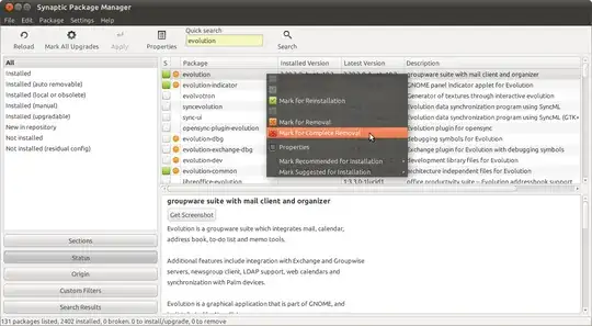

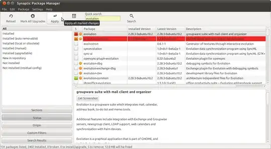

Open System -> Administration -> Synaptic Package Manager
Search For Evolution and mark them for complete removal
Now Apply the changes .
Now a new window will open and click apply again .
Evolution will be removed.
