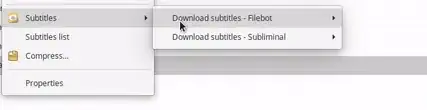

For example, after creating this setting in Nautilus action configuration tool:
which gives this:
the upper level menus like "Subtitles" and "Download subtitles" contain lines like ItemsList=3f0b618c-c6fe-436c-86a9-2ebd9b1a77dd;1601ae38-5d78-4214-aeef-b7feb9864fc7;d67b7f55-6b10-418b-bfe8-eb9d4e5e7732;66242038-c8b1-414f-9ef2-4d5bb831a027;, which are gconf settings that cannot really be edited manually in the text file, while the lowest level items (the actions themselves - EN, RO, FR, etc) do not have such code lines and can be edited.
