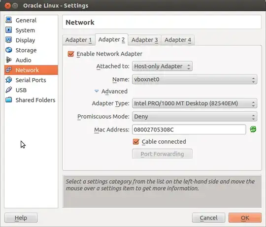

  • I have enabled a 2nd adapter as Host-only, so I can access the VM from the host (ssh or scp to guest VM from host, etc). This is working fine. The IP of the guest VM is manually set to 10.10.10.15 and I can successfully ping, ssh and scp to the guest VM without any problem. See below:
    Host-only configuration of 2nd adapter: Host-only configuration of 2nd adapter
Inside the VM, I have set up Apache successfully and it's working for localhost but when I try to access the page from the host, by entering 10.10.10.15 in Chromium or Firefox, it fails to connect! :(
