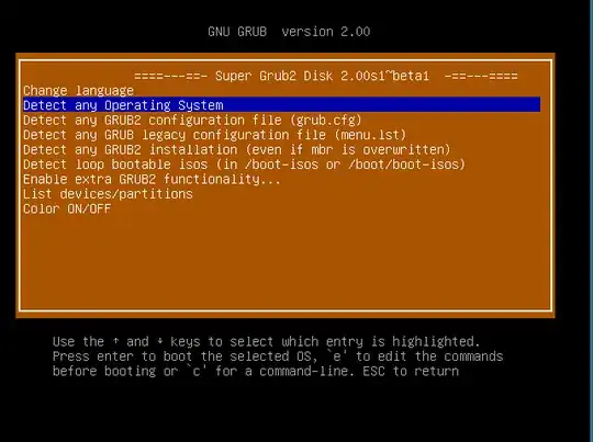

Use gparted to change partiton sizes or choose install alongside option [EASY] to install ubuntu. In case you install Windows 7 after Ubuntu and Ubuntu partitions are NOT deleted, download and burn this ISO file to a CD Super Grub Disk
Booting from CD this menu will appear.
Select 5th option to get old grub menu and boot Ubuntu. Open terminal and type
sudo grub-install /dev/sda
or
sudo grub-install /dev/sdb
You should get "operation completed without errors".
then
sudo update-grub
finally
sudo reboot
You will get your Ubuntu back.
I hope this makes things safe for you and installing Ubuntu without fear.
