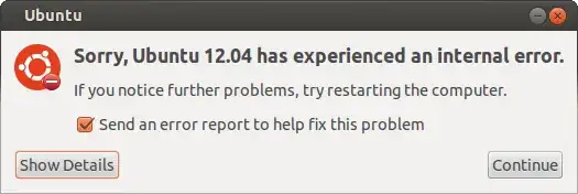

The system which intercepts crashes right when they happen the first time is Apport. When a crash happens, you will see something like this:

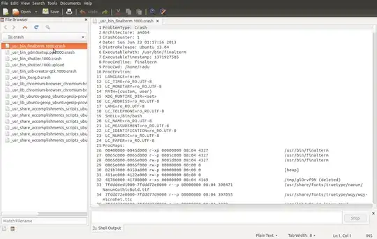

A report is written automaticaly in a file *executable_path.uid*.crash in the /var/crash directoty:
If you want to print one of these reports, you can run in terminal next command:
lpr <executable_path.uid>.crash
