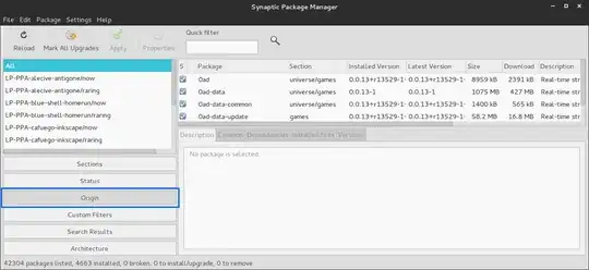

How can I determine which repository is being used for an installed packages? I have a few custom PPA repositories, and I'm concerned on one system whether the installed package is from one PPA or the other.

If you install synaptic (sudo apt-get install synaptic), you can use it to view the sources of packages:
Synaptic
