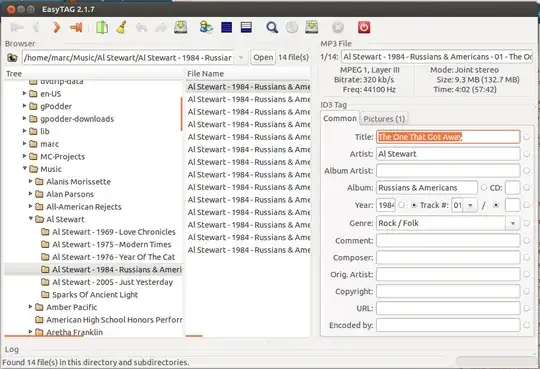

I don't know about you, but the thought of editing tags for several thousand tracks one by one is beyond what I'm willing to do. easytag has bulk editing which allows you to change one field of one or ten or a thousand tracks at once without disturbing any other tags.
