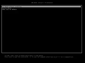

I was following the UEFI guide to install Ubuntu on a new computer but after reaching the screen below
and selecting install, the screen just turns black and nothing happens. I already disabled fast boot, safe boot, Intel SRT, and disabled raid.
Could you try to add the following boot options? (press e when you see that screen and add):
acpi_backlight=vendor acpi_osi=Linux video.use_bios_initial_backlight=0
Because, maybe the monitor backlight is turned off.
Press F6 to bring up the options menu and turn on "nomodeset". More can be found explained about nomodeset here: What does `nomodeset` do
