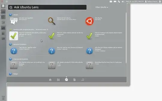

You can click on the Ask Ubuntu icon on your launcher (for 11.04), or inside your dash in 12.04 and 11.10. To get a fully expanded lens or you can hit the Super-U keyboard shortcut to summon the lens, then ask your question:
12.04 & 11.10 version:
11:04 version:

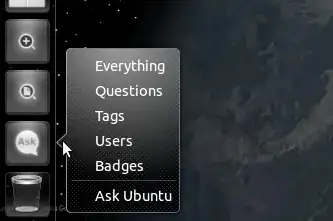

You can also right click on the icon and get a quicklist of different sub searches if you only want to search for a specific thing:

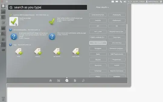

For 11.10
Now that we have scopes, you can just click "Filter Results" and select another Stack Exchange network site.
