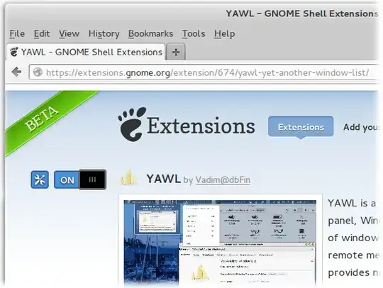

We can then install extensions by turning the switch on the upper left corner of the GNOME extensions download page to ON. Turning this switch to OFF will disable the extension.

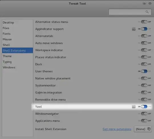

Loaded extensions or themes can then be further controlled with the GNOME tweak tool.
