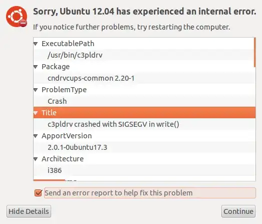

This morning, my Canon LBP6000 failed to print. After sometime, there was a message for system error, details of which was found to be something like this.
When I search for this error (c3pldrv crashed with SIGSEGV in write ()), I find a number of articles including this one. None of these are actually helpful. Mostly, these are 'me too', 'tell me if you find anything'.

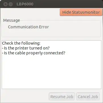

Running captstatusui -P LBP6000 produced this,
Yes, the printer is connected and actually turned on.
