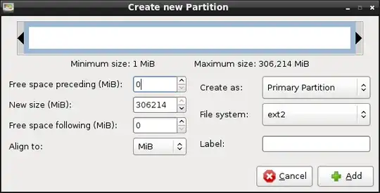

Assuming the figure of 1536kB (1.5MiB) is correct, you'll need to either use some manual alignment options in your partitioning software (GParted, parted, gdisk, etc.) or align on a multiple of both 1MiB (the default with most modern software) and 1.5MiB. Since 3MiB is the minimum value that satisfies both constraints, that's what you should use.
You're right that 1.5MiB is a bizarre value. It's such an odd value, in fact, that I'm a bit suspicious of it, and I'd err on the size of caution by aligning on a 3MiB boundary, or maybe even 6MiB (just in case the true value is 2MiB).
To do this, you need to understand your partitioning software's options. In GParted, you can't set alignment to an arbitrary value, just to none, cylinder, or MiB. Unfortunately, the user interface, although GUI, is a bit unclear:
GParted's partition-creation dialog box
You'd need to set the space via the "Free Space Preceding" box; but that's the free space between the new partition and the one before it, and where that one ends is unknown -- at least, not from the Create New Partition dialog box. The text-mode parted utility has similar problems.
If your disk should use GPT, I recommend that you use gdisk instead. (If you're booting in BIOS mode and want to use MBR, fdisk gives you more flexibility, but it still can't be set to use arbitrary alignment values, so you'll need to specify you partition start values manually.) You'll have a hard time installing gdisk in the Ubuntu installer, so it's easier to use System Rescue CD or Parted Magic to do the work. You can change the alignment by typing x to enter the experts' menu, using the l (or L) option to set the alignment (which you specify in sectors), and then using 'm' to return to the main menu, from which you can create partitions. It looks something like this:
