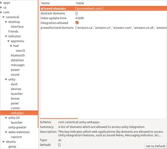

I use Chromium, installed unity-chromium-extension package. Also reset default dconf settings (see screenshot below).
I'm currently trying to install Grooveshark webapp, as you see already included grooveshark.com domain in the dconf settings, also installed unity-webapps-grooveshark package, but still cant make WebApps work in Ubuntu.

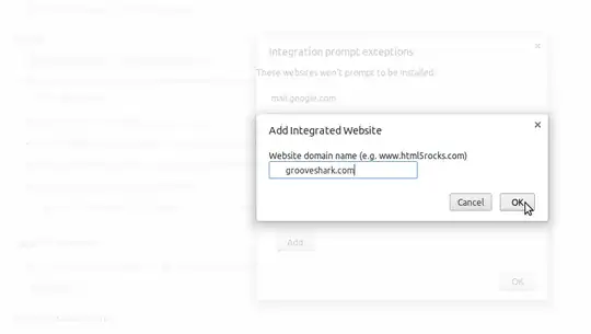

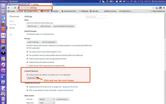

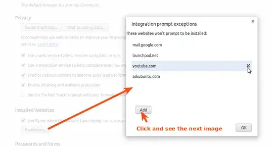

In Chromium, Desktop Integration is changed now to Installed Websites:
chrome://settings
Installed Websites
Add integrated website

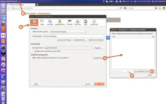

Firefox offers the same functionality through the General section:
Firefox Preferences
Until now you sow where you can find the exceptions for web applications and, implicitly, from where to remove this exceptions. Here is a list of sites that support integration in Ubuntu: http://www.omgubuntu.co.uk/2012/07/list-of-that-websites-support-unitys-new-web-apps-feature.
Related to Grooveshark Web App, according with this post, is not working for the new layout of the site.

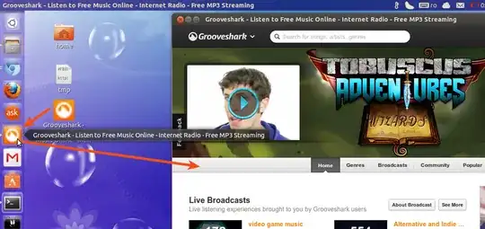

Add the application from desktop to Launcher by dragging and drop:
Application Shortcut
Dash

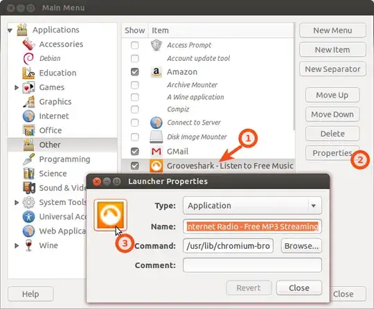

The last thing that you can do is to change the icon of application to a better one. To do this, search in Dash for alacarte to open Main Menu:
alacarte
In Main Menu search for the application for which you want to change the icon:
change app icon
