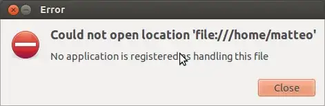

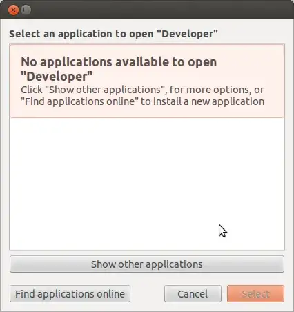

Fact is that now the only way to open a directory is to launch Nautilus via terminal. If I try to access it from the Places menu I'll be prompted with the following error:
As you can see the problem is that for some reason the File Manager is not registered any more for handling the directory files.

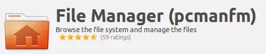

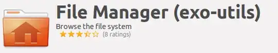

I looked for some file managers on the Ubuntu Software center and found a couple ones that helped me fix the problem,
but none of these is the default one I was using before.
