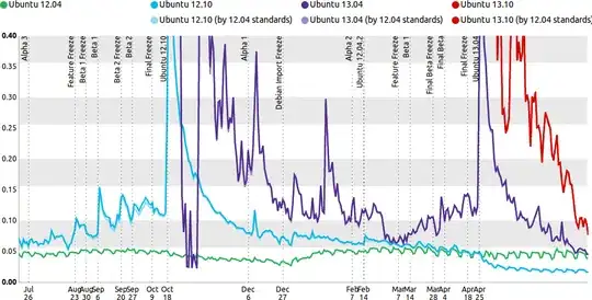

Technically, ubuntu-bug just logs the crash report locally. A separate program, whoopsie, watches for logged reports and uploads them to a central database, where they're automatically grouped to identify overarching problems.
The resulting data is displayed on the Ubuntu error tracker:
Graph of error reports in Ubuntu
Aggregate trends are publicly available, and report details are available to trusted developers. More details are available on the Ubuntu Wiki.

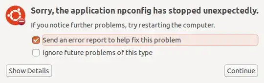

The collected information or report gets uploaded to a bug tracking system.
If any process in the system dies due to a signal that is commonly referred to as a 'crash' (segmentation violation, bus error, floating point exception, etc.), or e. g. a packaged Python application raises an uncaught exception, the apport backend is automatically invoked.
It produces an initial crash report in a file in /var/crash/ (the file name is composed from the name of the crashed executable and the user id). If the crashed process belongs to the user who is currently logged in, or it belongs to a system process and the user is an administrator, apport informs the user about the crash and offers to report the problem.
If the user leaves the "Send error report" checkbox enabled, Apport uploads the collected information to the bug tracking system. After that it opens the packages' bug filing page with a sensible default bug title and leaves the rest of bug filing process to the web UI.
