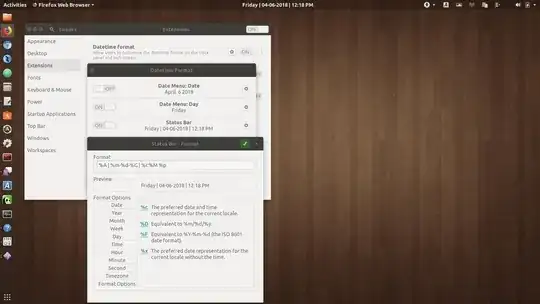

I was ultimately able to achieve my exactly desired format using a GNOME extension made by Daniel Khodabakhsh. Thank you Daniel!
I found that here: https://github.com/Daniel-Khodabakhsh/datetime-format
Screenshot: enter image description here
Format: %A | %m-%d-%G | %I:%M %p

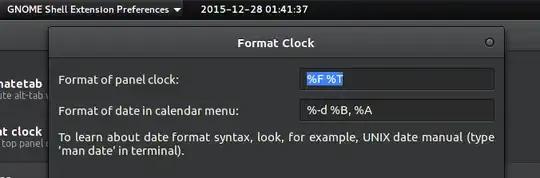

  • Format Clock (development discontinued, but apparently working fine in 3.16)
    enter image description here Change top panel clock format.
    It says the develpmont has been discontinued, but I tested it, manually editing metadata.json to include 3.18, and it works:
