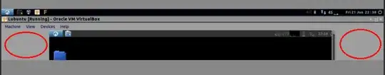

Performance is okay but I'm having trouble with the screen size. The desktop doesn't occupy the full width of the screen as the image shows (red ellipses).
VBox screen size
I can use "scale mode" but that looks ugly as though things have been stretched horizontally.

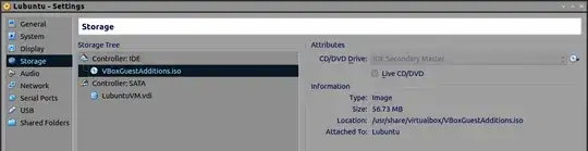

Some reading indicates that installing Guest Addditions would help. But I can't figure out how to install it. I have /usr/share/virtualbox/VBoxGuestAdditions.iso.
I've tried to mount VBoxGuestAdditions.iso:
Mounted-iso

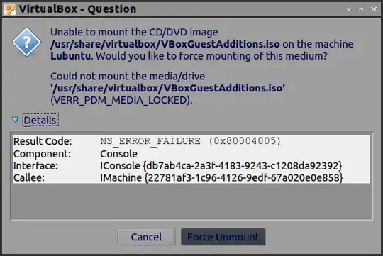

But when I click on Devices, Install Guest Additions, I see this window:
Force Unmount
Also puzzling is that there's an option to "force unmount" when the text above says "unable to mount".

Clicking the "Install Guest Additions" menu item just adds the iso to the virtual machine. You don't need to click it, because, in your case, the VirtualBoxGuestAdditions.iso is already attached to the virtual machine (as per the Storage tab of the virtual machine settings). It's named like that because the guest is supposed to automount the CD and autorun the installer, but I've never seen this behavior on Ubuntu, so the name is misleading in this case.
