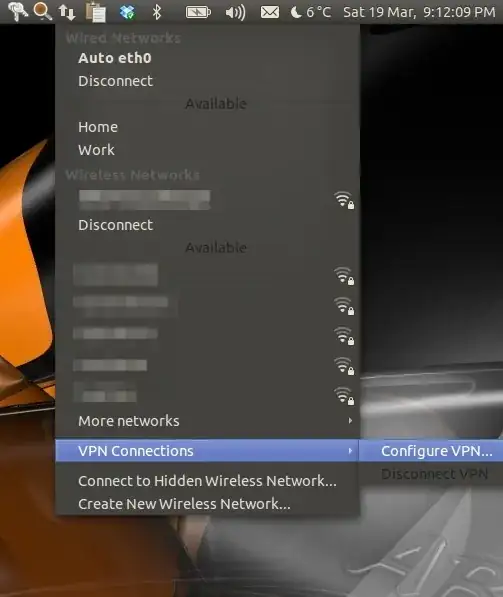

Now LEFT click on your network manager applet :
Network Manager

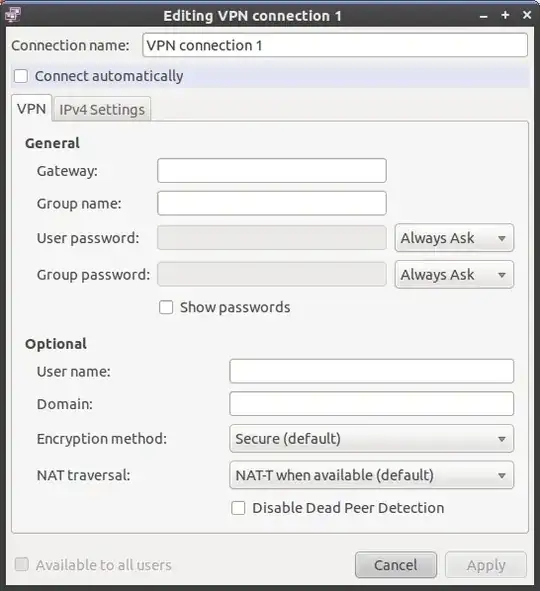

And choose "Configure VPN...", then click "Add" and drop the menu to "Cisco Compatible VPN".
VPN Configureation
And enter your details. To start your VPN, just follow the steps again, but instead of "Configure VPN", you'll click on the entry you created.
