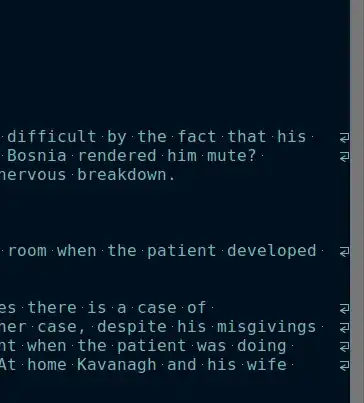

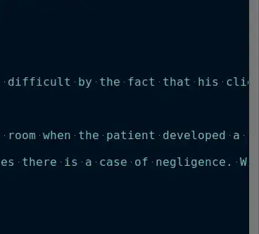

Press Alt+D and then L to toggle line wrapping on or off.
Line wrapping off
Line wrapping off
Line wrapping on
Line wrapping on

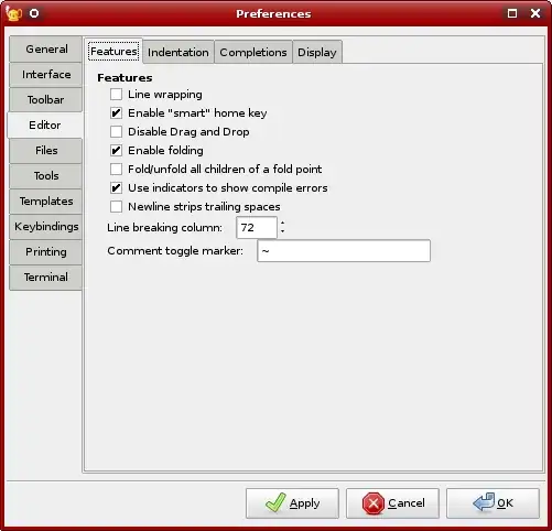

24
Go to Edit > Preferences. In the Preferences dialog, go to Editor > Features and then check the first checkbox (the one corresponding to "Line wrapping") :
air-dex

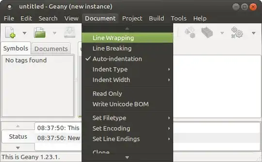

17
Open the menu Document and check Line Wrapping which is the top-most entry in the menu.
Pilot6
  • 92,041
There are three related parameters!
  • 'Document', 'Line Wrapping' checkbox;
  • 'Edit', 'Preferences', 'Editor', 'Features' tab, 'Line breaking column' numeric field;
  • 'Edit', 'Preferences', 'Editor', 'Display' tab, 'Long line marker' section, 'Column' numeric field.
In the 'Long line marker' section, you can also set the type of the marker and it's color.
