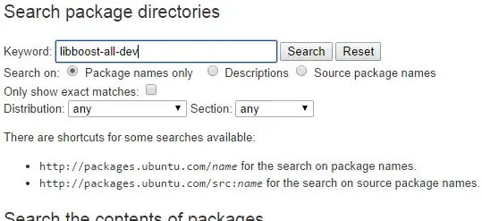

To find this information, I used packages.ubuntu.com, the online Ubuntu packages database.
People interested in finding specific information about what files are provided by Boost packages in their Ubuntu release, what packages provide them, and where they will be located on disk once installed can find that there.
Or, to get you started, here's a query that shows the libboost-all-dev package entries for all currently supported Ubuntu releases (and several others).
I got that by searching under Search package directories, changing Distribution to "any," and using libboost-all-dev as the search keyword.
