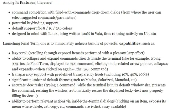

There is this very promising Terminal App Called Final Term. Among its many features, it also has a history of remebering commands, so that you can then select it. Here are some more features:
Final Term
You can read more about it in this article.
Here is the the website from the creators. http://finalterm.org/

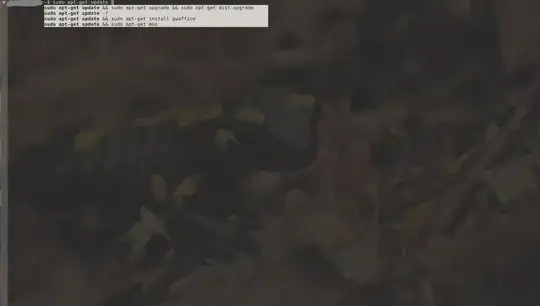

Screenshot
Here is the function in action:
 function in action
Hope this helps.
