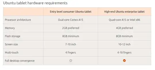

Unfortunately, your tablet does not match the spec requirements for Ubuntu for Tablets.
Ubuntu for Tablets specs

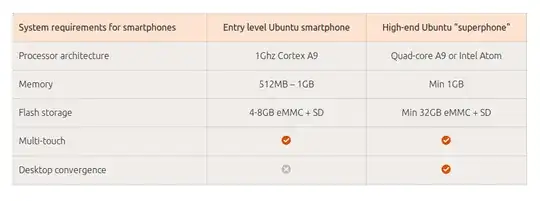

It does, however, match the specs for Ubuntu for Smartphones.
Ubuntu for Smart Phone Specs
So, in theory, you could run Ubuntu for Smart Phones and tweak the Unity 8 shell to run on the tablets resolution.
