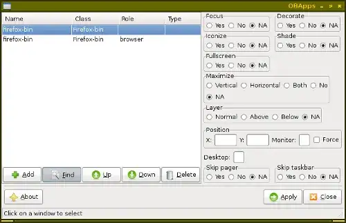

OBApps work for me. GUI for edit OpenBox options. Official page.
