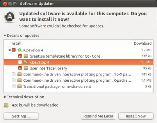

In Ubuntu 13.04, the Software Updater shows some apps as having updates, but they're non-selectable:
It's not clear why they're greyed out.
