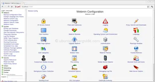

IMO the best graphical solution is webmin. Webmin is a graphical interface for server management and is better suited to server management then any of the desktops (unity/gnome/kde/etc).
Webmin pic
For webmin see: https://wiki.ubuntu.com/webmin
http://ubuntuserverguide.com/2012/06/how-to-install-webmin-on-ubuntu-server-12-04-lts.html
