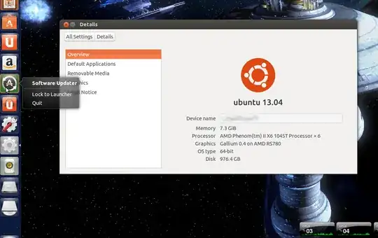

I am routinely getting software updates and I can see the software updater window is available to be displayed on the task bar in unity, but when I click on it I cannot get it to display.
The only way that I can get the updates to install is to right click on the task bar icon and advise it to install updates. I can not bring the update window up to see what I am installing.... :O (Hope I don't break it!) ;)

System was built and Ubuntu 12.10 was originally installed, with a subsequent upgrade to 13.04
I recently tried to install the AMD raedon drivers and broke it - so I reversed back and now run the stock driver (Not sure which one).
I can't recall if my issue started before this amd issue, or if was going on before that - I think they may be related.
The only way I can access this active window is via right click - it never shows on the desktop!
