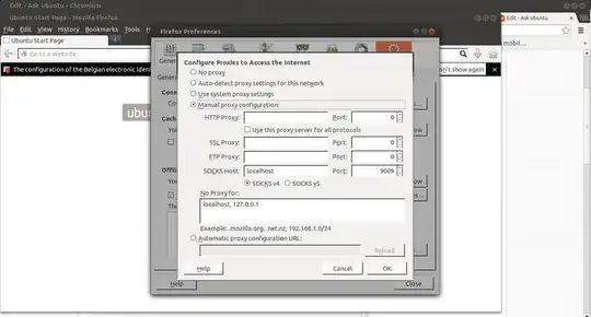

EDIT:
Step 1: remote laptop
$ ssh -ND 9009 sun@82.x.x.x
password: ......
Step 2: open firefox > do the settings like this:
Step 3: go to site icanhazip.com and start surfing
it works.
You could use SSH as a proxy and then use a local browser to use that proxy.
ssh -ND 8080 user@server.example.com
That sets a SOCKS proxy. Just edit your browser's proxy settings to IP: localhost Port: 8080 and your traffic is going out over SSH.
Just remember that all your browser's traffic is going through the proxy until you disable it so don't do anything against network policy while you're logged in. I might suggest using a private instance of Chrome, for example.
Note: This probably won't work for domain lookups so you'll need the local (to the SSH host) IP of the router.
