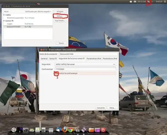

I've got to put a wifi password on my school laptops (all users are admin) but I don't want to the children see the password when you go edit conextions and edit de wifi like is see in the pictures. (I would like that you can't tick in the box NÂș3, so only dots will be seen) enter image description here

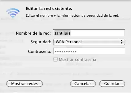

I would like sometihing like this that show key is like watermark so you can't see it and this screnshoot was taken in a admin acount (snox leopard osx (10.6.8) based with linux).

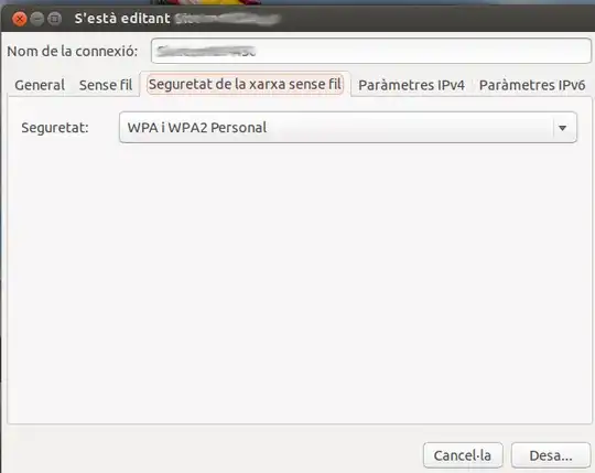

If founded with $ sudo gedit /usr/share/nm-applet/ce-page-wifi-security.ui and then you edit the line 55 and change True for False and in the network maneger it will appear like that. enter image description here
