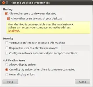

  2. vino-preferences. It will open vino-preferences.
    vino-preference
  3. Also Click configure network automatically to accept connection. But don't enter any password, its base64 encoded. Then click close. Then run:

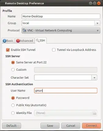

    On ssh tab click enable ssh tunnel. Under ssh authentication, it could be password or public key:
    remmina-preference
    Click save. And then double click connection-name(home-desktop as shown in the picture) to start browsing remote desktop.

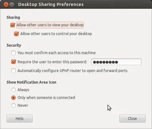

vino-preferences
  • vino-preferences also in Dash under Desktop Sharing
  1. Tick Allow other users to view your desktop
  2. Tick Allow other users to control your desktop
  3. Tick Require the user to enter this password
  4. Enter a difficult to guess passphrase
  5. Close

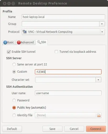

Create Remote Desktop Client profile on your Client Machine
Do the following on the client machine:
remmina
  • remmina also in Dash under Remmina Remote Desktop Client

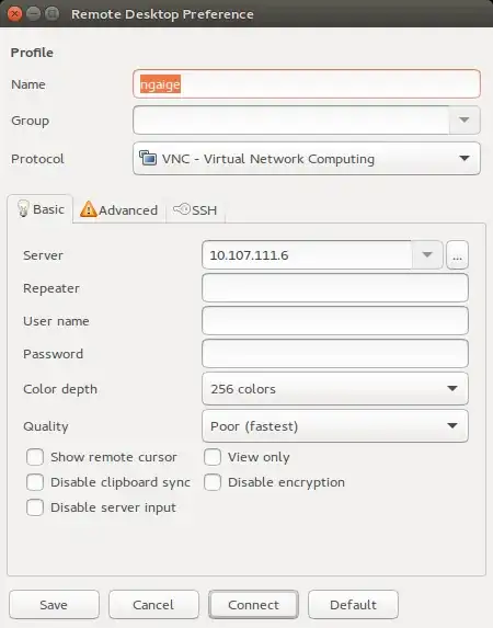

Ctrl+N or Connection > New
  1. Fill in your IP address [123.123.12.3] where it says Server
  2. Switch to the SSH tab
  1. Tick Enable SSH Tunnel
  2. Point your Desktop Client to your non-standard SSH port
  3. Set your SSH Authentication <username> and mode
  4. Connect
View and Control Host Machine
On the client machine, when asked for <username>'s password, enter it to create the SSH tunnel. When asked for the VNC password, enter the passphrase you previously entered into the host machine.
If successful at this step, you should now be viewing and controlling the host machine's desktop from your client machine through an SSH tunnel.

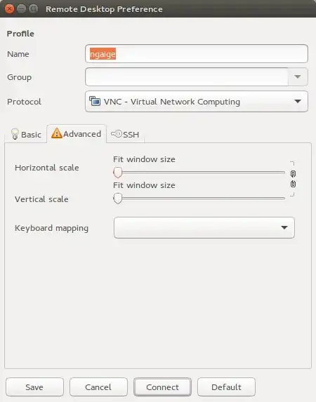

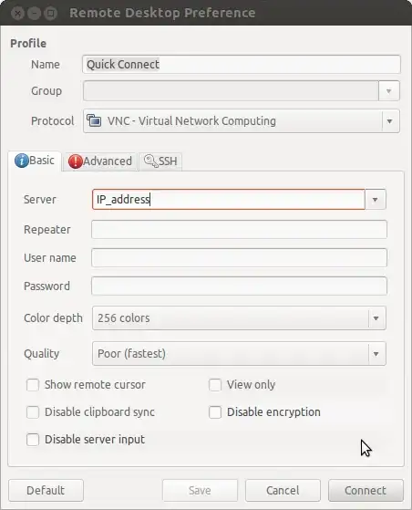

In the client PC (from where you want to control the server UI).
  • Keep the settings as shown in the images below (with changes at the place of username and IP).
*Basic* tab *Advanced* tab *SSH* tab

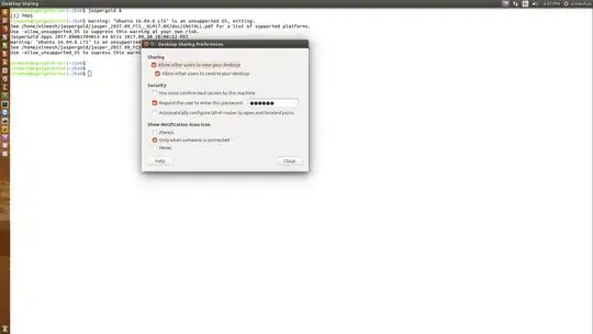

Pitfalls.
  • When I tried to set the vino-preferences in the server from a remote PC using SSH, it got changed, but the connection did not happen. I had to do it in the server machine directly (not remotely). I don't' know the reason for this behaviour.
