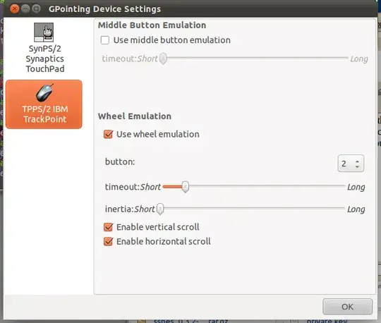

enter image description hereIMO easiest method is to install gpointing-device-settings
sudo apt-get install gpointing-device-settings
You then 'use wheel emulation'
gpointing-device-settings looks as in image.
try this it may help you out.

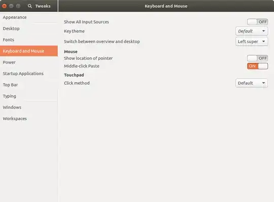

This is for future me mostly.
cat /etc/issue
Ubuntu 16.04.2 LTS \n \l
  1. Run gnome-tweak-tool
  2. Keyboard and mouse
  3. Middle-click Paste => ON
Gnome tweak tool on keyboard/mouse tab
