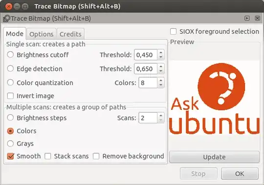

  5. Select Path - Trace Bitmap... for settings (below shown for 2 colors = "Scans" ):
  6. Select "Update" for a preview until settings are fine.
  7. Start tracing with "OK".

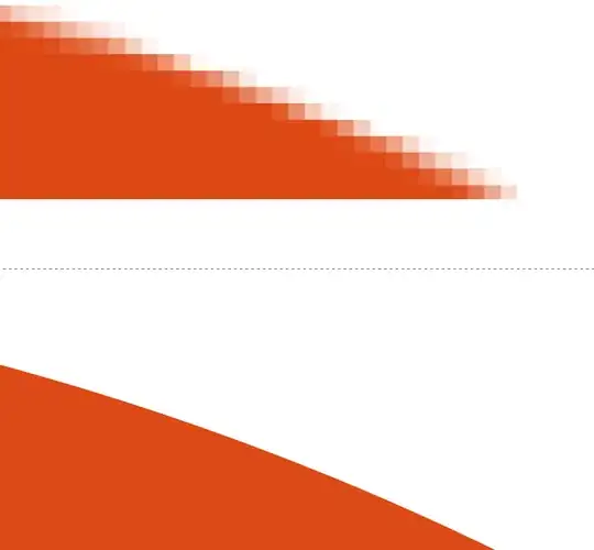

The advantage of a vector graphic can most rapidly be seen when we increase its size. Shown below was zooming to 2500%. Top is the original bitmap, bottom is the vectorized object:
This image and object was created from your original from chat
