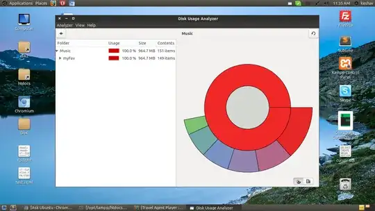

I have updated my ubuntu from 12.10 to latest Ubuntu 13.04. everything is fine but when i go to Places and click any place, it opens in Disk Usage Analyzer by default and i found no way to either stop Disk usage analyzer permanantely or to change the default Application for Places. Please tell me how to set it default so that Places opens properly.
Please see the image, I open Places > Music folder but it opens in Disk Usage Anylyzer

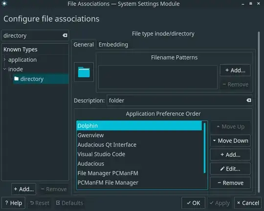

I'm running Kubuntu 17.10 and had a similar problem (in my case, it opened git-cola). Thanks to richq's answer I figured out the problem, but the solution different enough to warrant a separate answer:
Open File Associations (if plasma search doesn't find it: System Settings under Applications).
Expand inode and find directory - type it in the top-left search to filter out the rest:
File Associations screen
In Application Preference Order, select the application you want to use.
If it isn't at the top already, move it up, click Apply and see if this fixes things.

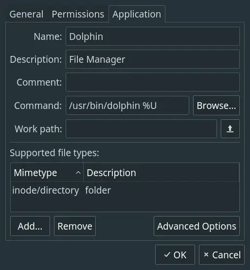

Otherwise, click Edit..., and open the application tab.
The Command field (fourth from the top) is probably not pointing to the actual program, so fix that. Make sure you keep the %U at the end!
For example, for Dolphin, it should probably look like this:
Edit command path to Dolphin
If you do not know where your desired application is stored, open a terminal and run whereis <application> (it's probably in /usr/bin/).
Anyway, that fixed it for me, hopefully this works for others too.
