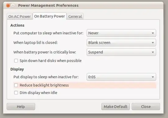

  • Press Alt + F2 to get the run dialog → type gnome-power- preferences and click on Run
  • On the On AC Power tab there is an option Dim display when idle that does exactly what it says → untick it and click on Make Default:
  • On the On Battery Power tab there is above mentioned option and another one (Reduce backlight brightness) for automatically reducing backlight brightness when on battery → untick both and click on Make Default:
There's another thing that was getting on my nerves with my ThinkPad T510: different backlight levels for GDM and session → read this question to find out how to completely stop gnome-power-manager from manipulating the backlight brightness.
