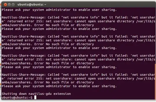

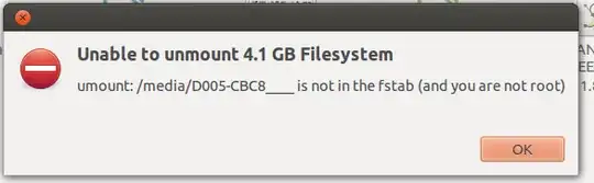

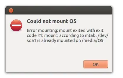

I am using Ubuntu 12.04 LTS on a USB on an HP Pavillion.
I posted a problem about removing Thunderbird. I was advised to use GKSU Nautilus to become root, or as I understand it, SUPERUSER. I could NEVER get it to work and I am now afraid I have screwed up my whole LINUX system. I can't get stuff to mount and then other stuff says it can't unmount (see images)
I have read that either using sudu or gksu can possiblibly lock the user out entirely. It seems that I am completely locked out as an administrator I can't even access the system settings/user accounts!
I am now completely overwelmed. I even tried to create a new USB loaded with 12.10 and was willing to overwrite everything and start new, but without being able to mount another USB I can't even do that.
I was going to (in desparation) try and run 13.04 from a DVD. I got as far as getting the ISO and it's files onto a DVD but now the DVD won't mount so I can't use it.
Have I screwed it all up with the GKSU command or perhaps the sudu?
It definitely seems as if I've lost any and all permissions.
HELP!!!!!
enter image description here enter image description here enter image description here enter image description here
