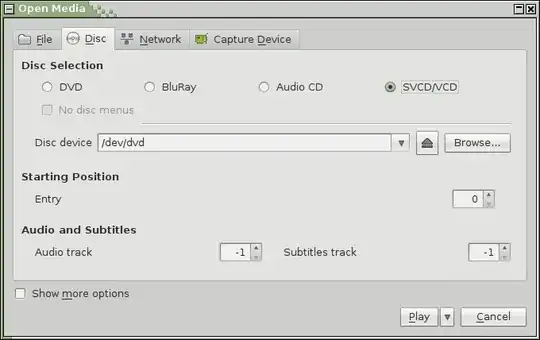

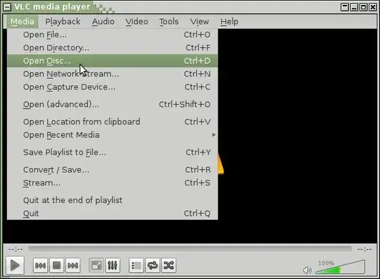

I'd recommend that you, instead of mounting the disc and accesssing the files via the file system, directly start playback of the vcd using a player that is capable of handling video cds like mplayer or VLC. To do this in VLC, either run vlc vcd:// or open the VLC GUI, go to the "Media" menu, click "Open Disc".
VLC media menu
In the following dialogue, select SVCD/VCD and input your drives /dev node (/dev/sr0 if I see correctly in your question).
VLC Open Disc dialogue
