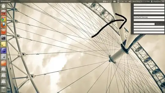

1. Right context menu changes (theme)
2. drop down-box change in top panel (theme)

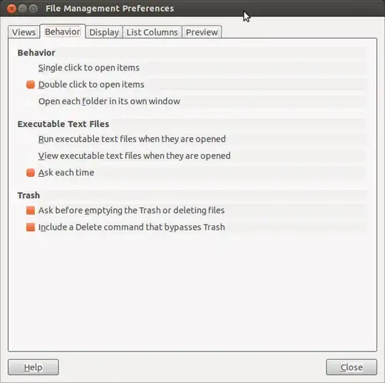

3. preview is not working in nautilus
I re-installed ambiance theme and ubuntu-mono-dark icon set. Other theme effects are good.
EDITED: How to solve this?
