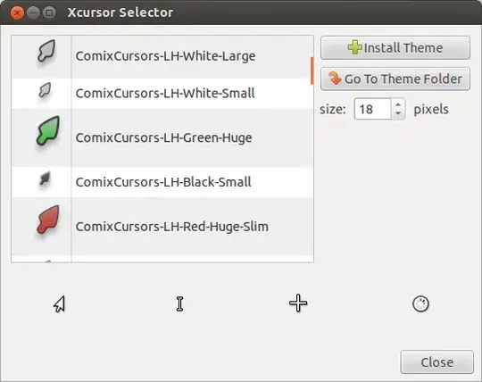

You have to install comixcursors-lefthanded Install comixcursors-lefthanded and gcursor Install gcursor (gnome cursor theme managing software). Although gcursor doesn't seem to do install the theme for me it is useful to see what a cursor theme looks like.
gcursor
The theme ComixCursors-LH-White-Small looks the most decent, so let's pick that one

Yes, there is. You have to install comixcursors-lefthanded Install comixcursors-lefthanded and gcursor Install gcursor (gnome cursor theme managing software).
Open gcursor an choose what cursor theme do you wish.
