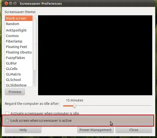

There are a few areas of the system that you can utilize to process this request. First being the "Screensaver Password" that you mention. Go to System > Preferences > Screensaver In there, you need to disable the checkbox titled "ALock screen when screensaver is active"

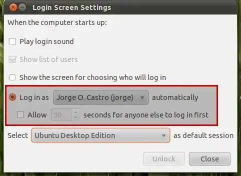

On the login screen you can set an auto-login to a user. System > Preferences > Login (this may be system > administration > login.. please verify as I'm not in-front of my Linux PC) you can then set the system to auto-login a given user.
However please note that after you have logged in, if you have stored passwords in your couchdb it will prompt you to enter your password to unlock the keyring so your wifi can auto connect (as an example)

That said: for the screensaver, go into the screensaver preferences and uncheck the option to ask for password. For administrative tasks, visudo and change yourname ALL=(ALL) ALL to yourname ALL=(ALL) NOPASSWD: ALL.

More simple way...
1.Go to gear icon on top right corner.
2.Go to system settings.
3.Go to user accounts,bottom right corner(depends on UI)
4.Click the button unlock,it will prompt for password.
5.Enter the password for particular user.
6.Slide the bar of Automatic login from OFF to ON.
7.Here you go..click the lock button again.
Thanks..Hope it works.
